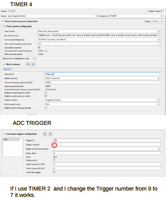

Dear all,
I'm developing a project based on LPC55S28 processor
I have very simple question: How to use CTIMER4 as hardware triggerfor ADC conversion ?
I developed as simple software on LPC55S27-EVK board. If I use CTIMER0 as hardware trigger (ct0_mat3_out trigger 5)  it works. If I use CTIMER4 as hardware trigger (ct4_mat3_out trigger 9) it doesn't work.
Did you have similar problem ?
How did ypou fix it ?
Thank you for your help and cooperation

Hello @_Ferrari_
First please confirm the CTIMER4 and output works well.
3,140 Views
Hello @_Ferrari_
There should be some issue with your configuration code please check.
For example pin clock enable, pin configuration, and also check whether there is output of CTIMER.

I checked LPC55xx user manual
and this is my configuration
How did you fix it ?
Thank you very much for your help and cooperation
best regards
