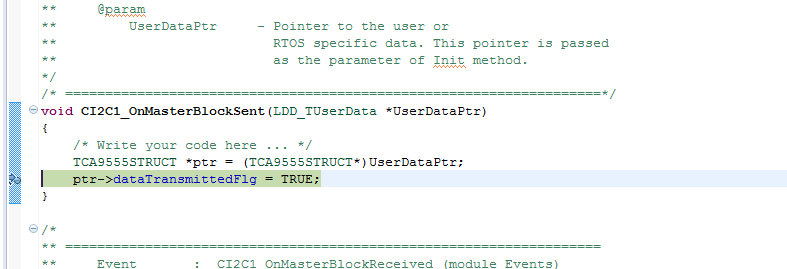

I've disabled I2C_LDD interrupt as shown
Then generate the PE code, compile and debug. Finally I set a breakpoint in the I2C tx event routine and the execution halts as shown
This is a non expected result. How can I disable these rx/tx I2C interrupts?

The problem is DataTransmittedFlg is not changed to true by Events (I2C interrupts disabled) nor I2C_Main function. So the execution is stuck at the first while()

When the interrupt service is disabled the Main() function is called in the application. This function calls events that are enabled. See the following part of the source code of the Main() function:
if ((DeviceDataPrv->EventMask & LDD_I2C_ON_MASTER_BLOCK_SENT) != 0x00U) {
  CI2C1_OnMasterBlockSent(DeviceDataPrv->UserData); /* Invoke OnMasterBlockSent event */
If you want to disable calling of the event you must use the SetEventMask() function of the I2C_LDD component.
For example:
SetEventMask(MyI2CPtr, 0); /* disable all events */
