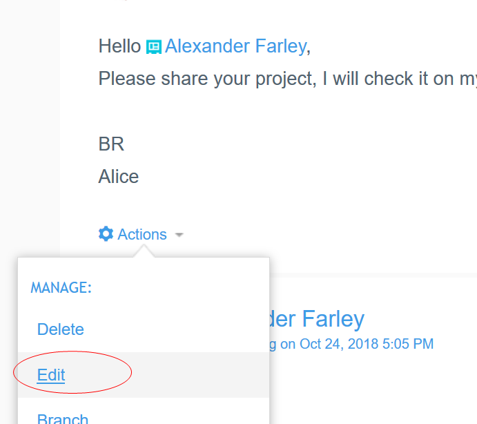

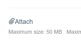

   Hello Alex,
I'm very sorry , we are restricted into google drive in your company,  I have asked the our IT, there is no method to access it . So could you please attached your project in the community as below steps:
Edit -> Attach:
Alice
