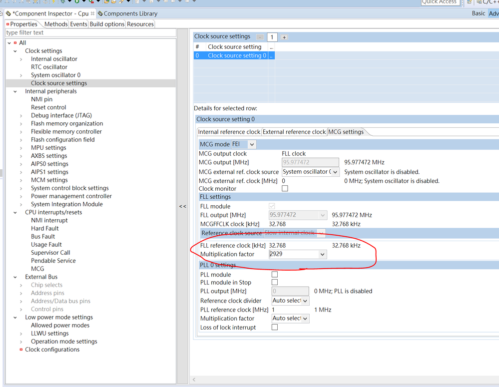

Dear all,
I use the processor expert to generate a new project for MK60DX256VLQ10  on KDS 3.2.0.
But the result system clock is about 20MHz, the MCG output is also 20MHz system clock.PNG
And i can't find option to increase the clock speed.
how can I increase the clock up to 96MHz by processor expert?

I find the solution to increase the clock,
select the multiplication factor to adjust the clock.
