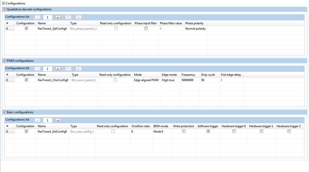

I wamt to output PWM using FTM module by Processor Expert. I have added init_FTM component to initilize the FTM module. However, there is nothing output from the pin I choose. What elas should I do? Should I add fsl_ftm or fsl_ftm_hal component?
I just want to output 50MHz PWM from on channel and I use KDS3.0.

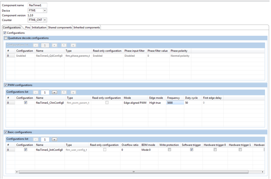

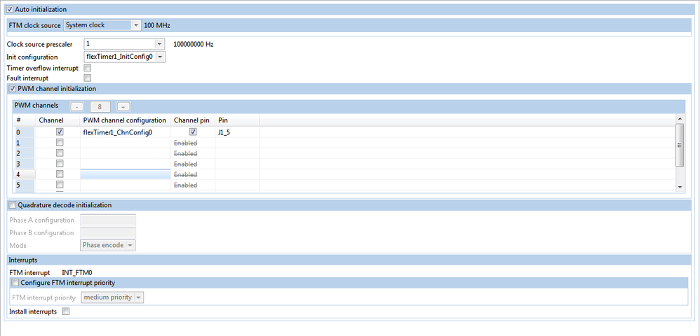

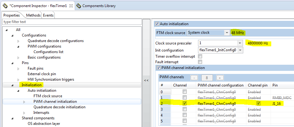

These are all my configurations, it is working Ok. I am using the FRDM-K64F.
Earl.

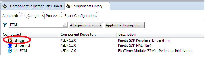

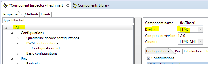

You need to add the component fsl_ftm. Once it is added, in the Properties tab in the Component Inspector you will see the PWM Configurations.
Earl.

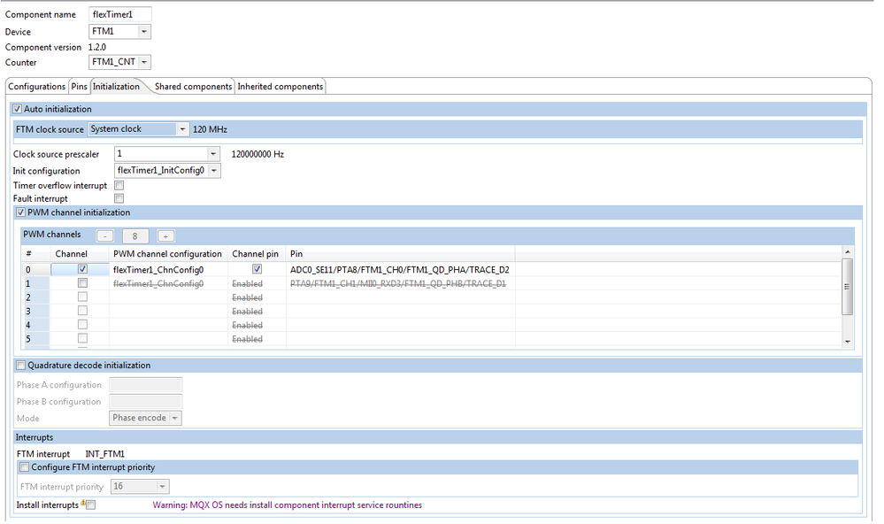

You don't need the FTM_Init component. The fsl_ftm component includes the initialization, in the Component Inspector you can select the FTM instance that you want to use.
Also, if you need a 50MHz signal you need to configure your system clock as a multiple of 50 MHz (50 MHz, 100 MHz, etc). In the Initialization option you will be able to select what FTM channel(s) you want to configure as PWM output.

Hi Earl, I have done all of this. But there is still no signal from the pin. Could you help me about this? Which one I set is not correct ? Many thanks for your kind help!
6,847 Views
EarlOrlando
Senior Contributor II
Earl.

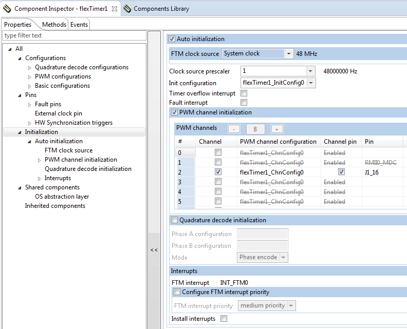

albertolubeiro

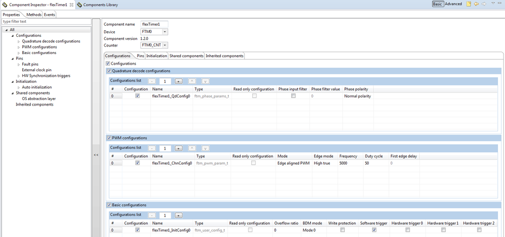

Hi Earl,
Apparently, i have done the same configuration options that you have but i don't get it to work. I am using KDS3.0.
Here is the bean i have selected.
Of the  following, i'm only edit de configuration and initialization options as shown.
Then in "Components_Init" function, the PEX creates these functions:
/*! flexTimer1 Auto initialization start */
  FTM_DRV_Init(FSL_FLEXTIMER1,&flexTimer1_InitConfig0);
  FTM_DRV_SetClock(FSL_FLEXTIMER1, kClock_source_FTM_SystemClk, kFtmDividedBy1);
  FTM_DRV_PwmStart(FSL_FLEXTIMER1,&flexTimer1_ChnConfig0,0U);
  FTM_DRV_SetTimeOverflowIntCmd(FSL_FLEXTIMER1,false);
  FTM_DRV_SetFaultIntCmd(FSL_FLEXTIMER1,false);
  /*! flexTimer1 Auto initialization end */
What else shall i do, in order to make the FTM works?
Any help will be apreciated
Thanks and best regards.

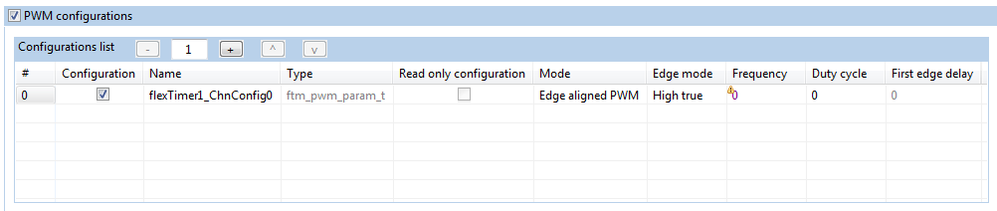

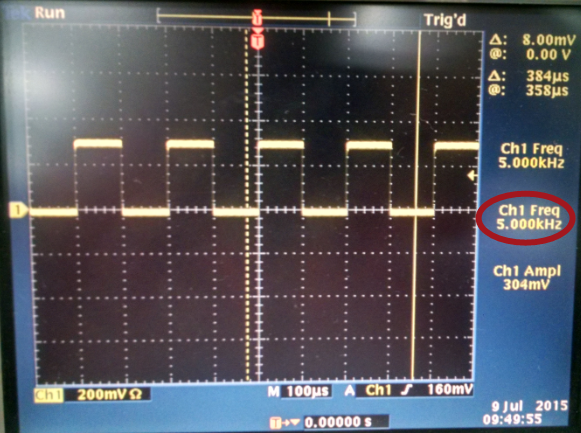

Hello Alberto,
I have the same configurations and I get this 5 KHz signal:
I attach my project.
Earl.
