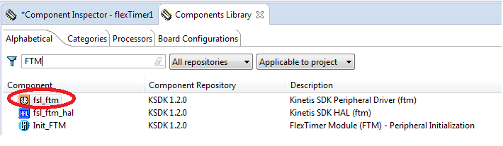

You need to add the component fsl_ftm. Once it is added, in the Properties tab in the Component Inspector you will see the PWM Configurations.
Earl.

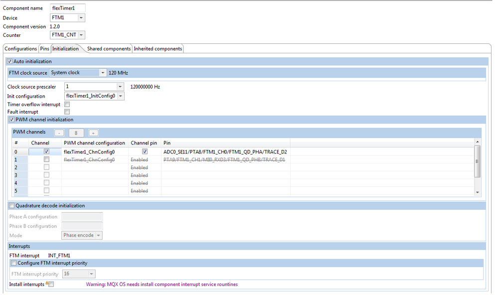

You don't need the FTM_Init component. The fsl_ftm component includes the initialization, in the Component Inspector you can select the FTM instance that you want to use.
Also, if you need a 50MHz signal you need to configure your system clock as a multiple of 50 MHz (50 MHz, 100 MHz, etc). In the Initialization option you will be able to select what FTM channel(s) you want to configure as PWM output.

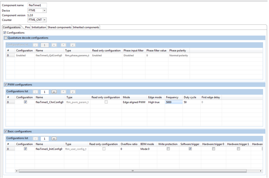

albertolubeiro
Hi Earl,
Apparently, i have done the same configuration options that you have but i don't get it to work. I am using KDS3.0.
Here is the bean i have selected.
Of the  following, i'm only edit de configuration and initialization options as shown.
Then in "Components_Init" function, the PEX creates these functions:
/*! flexTimer1 Auto initialization start */
  FTM_DRV_Init(FSL_FLEXTIMER1,&flexTimer1_InitConfig0);
  FTM_DRV_SetClock(FSL_FLEXTIMER1, kClock_source_FTM_SystemClk, kFtmDividedBy1);
  FTM_DRV_PwmStart(FSL_FLEXTIMER1,&flexTimer1_ChnConfig0,0U);
  FTM_DRV_SetTimeOverflowIntCmd(FSL_FLEXTIMER1,false);
  FTM_DRV_SetFaultIntCmd(FSL_FLEXTIMER1,false);
  /*! flexTimer1 Auto initialization end */

Hello Alberto,
I have the same configurations and I get this 5 KHz signal:
I attach my project.
Earl.
