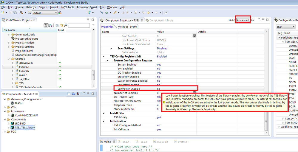

I am working on a small message panel using a Kinetis KL05 device. I want it to stay in a low-power mode, keeping the message to be displayed in RAM. Thus, I decided to enter VLLS3 mode. I want to wake up the device using a TSI electrode, and I have configured the PE TSS_Library component to use PTA9 as the wakeup electrode. CPU component is configured to FEI clock mode (default). I can use the Cpu_SetOperationMode() function to put the device into VLLS3, but my TSI electrode does not wake it up.
I am not using a FRDM board, it is a custom board, with an external USBDM debugger. There is an LED connected (cathode) to pin PTB1. The test project (CW10.6) is attached to this question.
I know that there are some examples for low-power wakeup, but I would prefer a step-by-step description of how can I program the device for working as described above. For example, if I have to configure RTC to hardware trigger the TSI, if I can use the LPO source for RTC, and so on.

I have checked your application and I see following issue:
The TSS Config Register Init\System Configuration Register\LowPower Enabled must be set to yes. See below:
The TSI functionality in the VLLS3 power mode is restricted, see the description in the reference manual:
TSI module is fully functional in all of the stop modes as long
as TSI_GENCS[STPE] is set. The channel specified by
TSI_DATA[TSICH] will be scanned upon the trigger. After
scan finishes, either end-of-scan or out-of-range interrupt can
be selected to bring MCU out of low power modes.
You must also configure the LLWU device and enabled TSI0 as the wake-up source.
