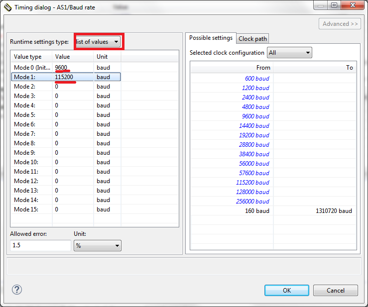

if we have select  Uart component ,in that we have take different baudrates.so how to initialize different different baud rate through component?
1,855 Views
vfilip

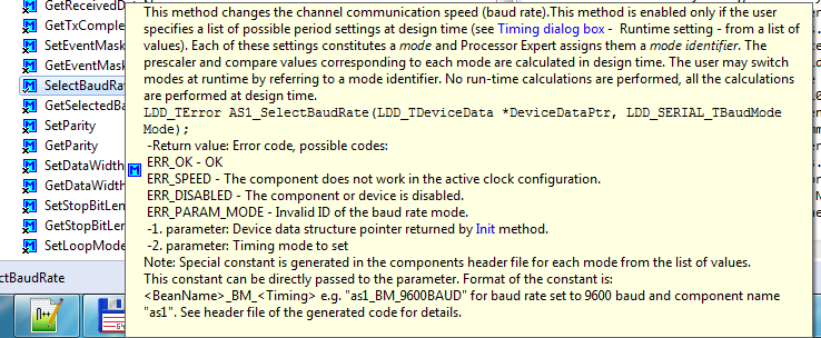

I assume you are using Serial_LDD. In this case just select "list of values" in Timing dialog. There is also associated SelectBaudRate function to update the communication speed in run-time.
