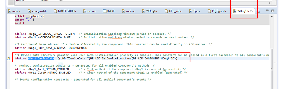

Hello gaston,
Please see the file of "WDog1.h" , it have define the "WDog1_DeviceData" .
If still have any question , please contact me !
Alice

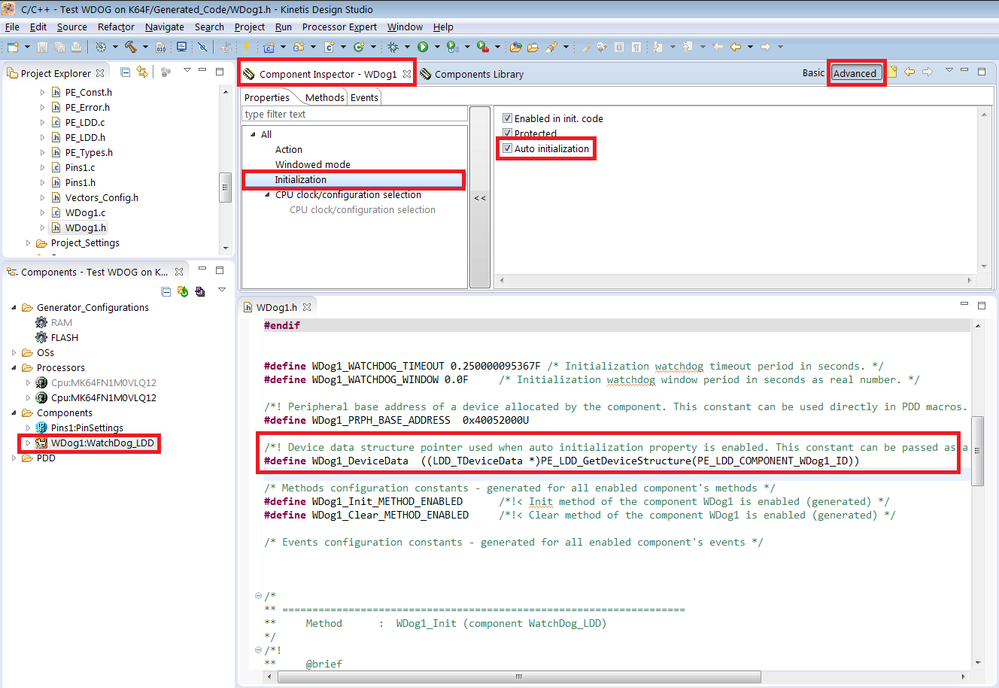

marek_neuzil
Hello Gaston,
It seems that you have not enabled the Auto Initialization in the WatchDog_LDD component.
In the WatchDog_LDD component, set the Initialization/Auto Initialization property to the "yes" value and generate Processor Expert Code. The following definition will be generated in the WDog1.h header file:
Marek Neuzil

gschelotto
Contributor V
Yes Marek, I have to set the Initialization/Auto Initialization property to the "yes" to generate the definition. Anyway I think that it has to be created if the property is set or not. Don't you think so?
