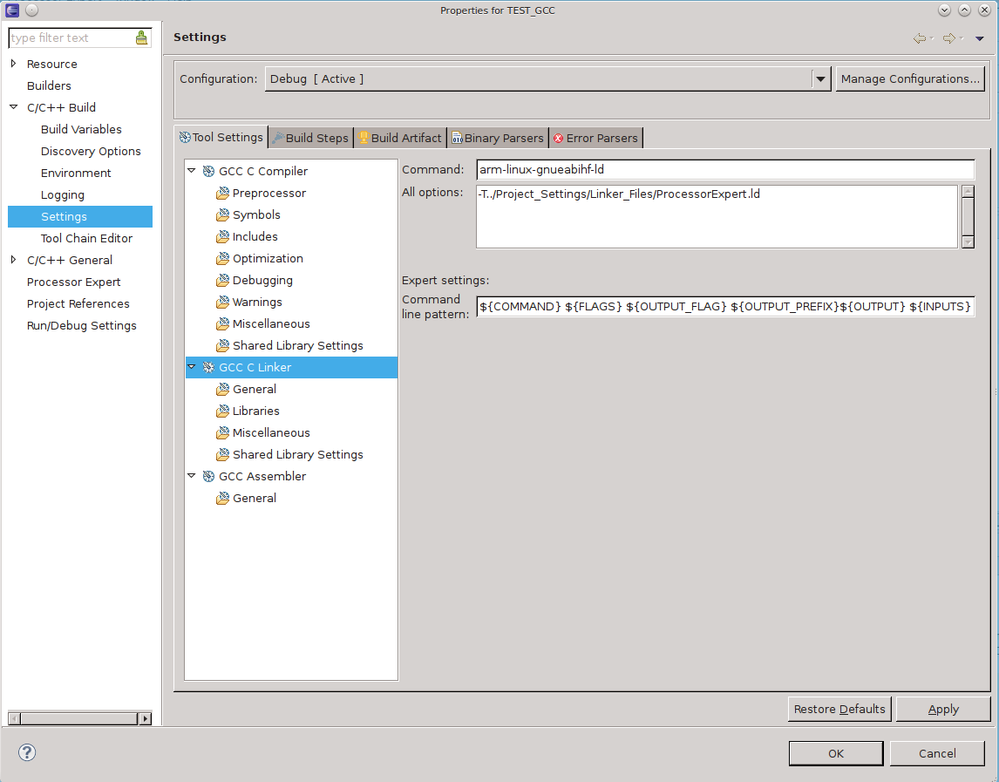

jackblather
Senior Contributor I
Hi Vojtech,
I created an entirely new PEx project in DS-5 this time, called 'SecondPE' to make sure I didn't mess something up: New --> Project --> Processor Expert Project --> (Processor MVF61NN151MK50) --> Use current perspective, Initialize all peripherals -> GNU C Compiler.
When it created the project, I looked at the properties for the PEx project. In the Tool Chain Editor, for "Current toolchain", I selected "DS-5 GCC". For "Current builder", I selected "Processor Expert Configuration Debug Builder". Is this what you mean by using the "PEx generated linker file"?
Under "Build Options" in the PEx projects, "Generate linker file" is already set to "yes"
I added "Generated_Code" and "Sources" to the include paths.
I then cleaned and then built the project and I get these messages when it tries to link

I suspect that the DS-5 GCC compiler isn't the right choice? It's the only GCC compiler available besides the Timestorm GCC compiler. When I try to use the Timestorm GCC compiler, Eclipse says: "java.lang.NullPointerException" so I can't use the Timestorm GCC compiler.
Do I need to specify to the compiler the CPU type? I also tried adding this to the GCC compiler and GCC assembler configs in the project:
-mcpu=cortex-a5 -mfpu=vfpv4-d16
and got the same result.
Is there some linker config I need to set up?
Thanks.

vfilip
I these errors are caused by GCC compiler/linker incorrect setup. I do not have much experience with DS-5 and PEx integration however I would recommend the following steps.
Create new standard C project in DS-5 (without PEx) for your MCU. This step should ensure that corresponding toolchain will be set properly.
After that right click on your project and select "Enable PEx in existing C project".
Try to generate and build your project.
Please find also attached steps for IAR, in your case just replace IAR by requested toolchain.
If this not help I will prepare exact steps for DS-5 and PEx for you.

vfilip
regarding GCC. I was able to get the project linked when I switched directly to the arm-linux-gnueabihf-ld.exe and add path to linker file -T../Project_Settings/Linker_Files/ProcessorExpert.ld

Yes, I'm using DS-5 GCC, because PEx doesn't support the ARM CC compiler. This is on 32-bit Ubuntu 12.10. My ARM DS-5 installation is v5.16 with PEx, update, and the Vybrid Service Pack.
Using the ARMCC compiler, I was able to get the same successful results you did. This is the first time I've been able to compile PEx code without errors.
Using the DS-5 GCC Compiler, I made the changes you outlined and I get errors:

It seems that the DS-5 GCC compiler doesn't understand the '#pragma arm' pragma.
FYI, I checked the "Project_Settings/Linker_Files" directory and there is no "ProcessorExpert.ld" file, only ProcessorExpert.scat. Is the .ld file a temporary file?
Thanks.

vfilip
I have reproduced the errors reported in your original post. Since there is no workaround for this problem we will try to prepare hot-fix for you as soon as possible.
Vojtech Filip
Processor Expert Support Team
46,118 Views
vfilip
please find the hot-fix for you issue attached. To apply it please copy ProcessorExpert folder in the archive over existing ProcessroExpert component in your installation of Driver Suite on your disc.
We are sorry for inconvenience.
