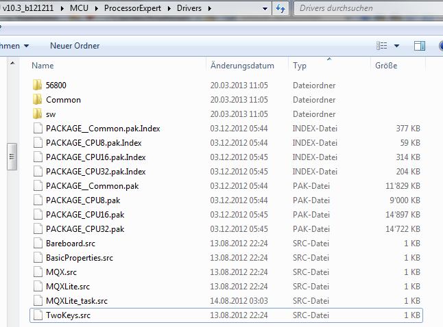

I believe your problem is in one of the files in
MCU\ProcessorExpert\Drivers
Drivers\Kinetis\SDHC_LDD.rgi is in one of the packages (not sure which one).
Are you sure you have not loaded any Processor Expert service packs for an addtional processor/CPU?
I ask because that error message let me believe something is missing.
2,325 Views
BlackNight
Here is what I have inside that folder:
Do you have the same?

sorry just getting back to this... yes that file directory looks the same as mine, Eric.
