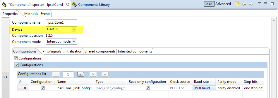

When using KSDK + PE and choosing the fsl_uart component, the devices available are UART1 and UART2.
But, the UART0 does not appear! How I proceed?

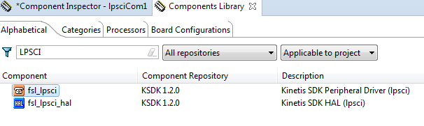

If you want to use the UART0 you need to use the fsl_lpsci component:
This is because the UART modules are supported by different HAL/drivers, the UART0 module is supported by the LPSCI HAL/driver and the UART1 and UART2 modules are supported by UART HAL/driver.

Thanks Carlos,
It works! I felt a lack of documentation about the Kinetis sdk! Where would I found about this, if not on Kinetis forum?
