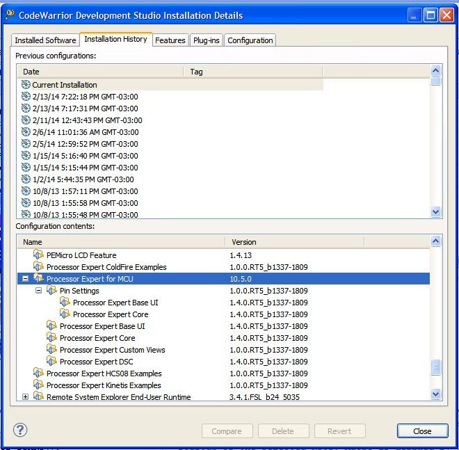

chrled
Hi Petr,
Would you please tell me how to know if I need to install this hot fix ?
Do the updates fix that issue or I still need to install the hot fix ?
I install CW 10.5 on Oct 2013:
     Processor Expert for MCU
     Version 10.3.0
     Build: RT5_b1337-1809
     Copyright © 2007-2013 Freescale Semiconductor, Inc.
Christian
