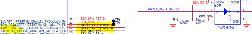

Hi Jorge, I'm currently revisiting my K64F project, and figured I'd close the loop and see how your explanation matches up.  Can you please explain one more thing?  I'm looking at the K64F schematic right now, and this is what I see:
Normally, I believe I have the osa1 UART device set to UART0, and RxD and TxD are UART1_RX_TGTMCU and UART1_TX_TGTMCU.  Is this a bug in PEx?  I'm jumping between so many projects right now I can't remember if this is the one where printf to the virtual COM port isn't working, but if not, maybe this is why.
If I select UART1 from Device, then I can't assign the RxD and TxD signals in PEx as they appear in the schematic.

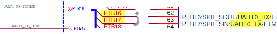

Jorge_Gonzalez
Hi Dave:
That is for the K20 MCU (OpenSDA interface).
Actually the pins used from the K64 MCU correspond to UART0 module. Check the next image:
Regards!
Jorge Gonzalez
