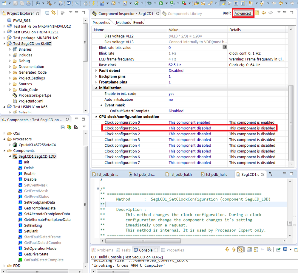

marek_neuzil
When you add second clock configuration into the CPU component the default state of the SegLCD_LDD component  in this clock configuration is disabled, see the following screenshot of Component Inspector (use the Advanced view):
The source code of the SegLCD_LDD Init method is modified. The following code is generated:
SegLCD1_SetClockConfiguration(DeviceDataPrv, Cpu_GetClockConfiguration()); /* Set Initial according speed CPU mode */
(instead of LCD_PDD_EnableDevice(LCD_BASE_PTR,PDD_ENABLE); /* Enable device */)
The SegLCD1_SetClockConfiguration() method contains the following code that enables or disables the LCD device according to selected clock configuration of the CPU:
**     Method      :  SegLCD1_SetClockConfiguration (component SegLCD_LDD)
**     Description :
**         This method changes the clock configuration. During a clock
**         configuration change the component changes it's setting
**         immediately upon a request.
**         This method is internal. It is used by Processor Expert only.
void SegLCD1_SetClockConfiguration(LDD_TDeviceData *DeviceDataPtr, LDD_TClockConfiguration ClockConfiguration)
  SegLCD1_TDeviceData *DeviceDataPrv = (SegLCD1_TDeviceData *)DeviceDataPtr;
  switch (ClockConfiguration) {
    case CPU_CLOCK_CONFIG_0:
      DeviceDataPrv->EnMode = TRUE;    /* Set the flag "device enabled" in the actual speed CPU mode */
      LCD_PDD_SetClkSource(LCD_BASE_PTR, LCD_PDD_ALTERNATE_CLK); /* Set CLK source */
      LCD_PDD_SetAlternateClkDivider(LCD_BASE_PTR, 0x01U); /* Set value of LCD Alternate divider */
      LCD_PDD_SetClkPrescaler(LCD_BASE_PTR, 0x04U); /* Set value of LCD clock prescaler */
      break;
    default:
      DeviceDataPrv->EnMode = FALSE;   /* Set the flag "device disabled" in the actual speed CPU mode */
      break;
  HWEnDi(DeviceDataPtr);               /* Enable/disable device according to status flags */
When you want the SegLCD_LDD component (LCD device) to be enabled in all (both) clock configurations you must select the "This component enabled" value in the "CPU clock/configuration selection/Clock configuration 1" property.

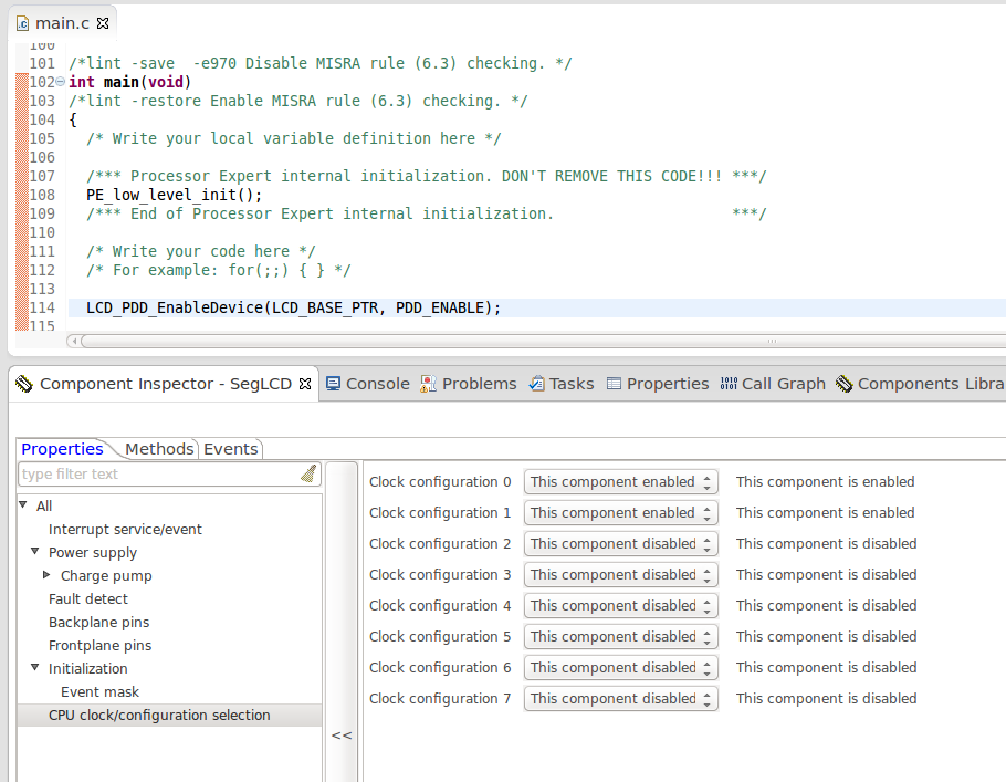

rolfbensch
Hello Marek,
If I'm enabling both clock configurations for the SegLCD_LDD component, the LCD device stays disabled until I add "LCD_PDD_EnableDevice(..);" as first command into main.c.
If I'm working with one clock configuration for the SegLCD_LDD component, the LCD device stays disabled, even if I manually switch to the active CPU clock.
In both configurations I checked "Enable in init. code" and "Auto initialization".
As said in my first posting, everythig is working fine if I'm using one CPU clock. But in the meantime I need 4 cpu clock settings with disabled LCD for the 4th cpu clock.
Many thanks for your help,
Rolf
