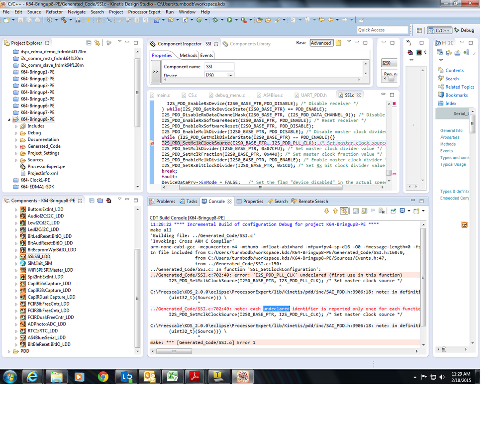

SSI_LDD component gives an error "error: 'I2S_PDD_PLL_CLK' undeclared".
3,299 Views
dougturnbow
If I manually change it to I2S_PDD_PLL_FLL_CLK I can get past it, but I have to do this every time I generate PE code.  Is there a workaround for this?
screenshot.pngIf I manually change it to I2S_PDD_PLL_FLL_CLK I can get past it, but I have to do this every time I generate PE code.  Is there a workaround for this?

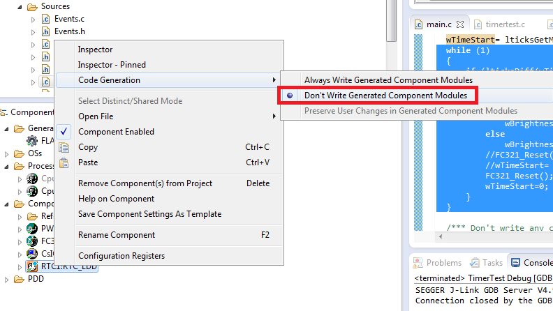

marek_neuzil
if you want to disable modification (update) of the generated code of any PEx component in your project you can choose Code Generation/Don't Write Generated Component Modules option in the context menu of the component in Components window, see the following screenshot:
Marek Neuzil
3,136 Views
dougturnbow
Thanks Marek, that is a great workaround and adequate for my needs.
