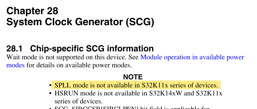

Hi,I am a green hand try using Processer export provided by S32DS For ARM V2.2 to configure clock source.
I've encountered a problem that I can't using SPLL_CLK ,the warning indcates that clock source should not be disabled.
Where shall I do to enable such clock souce? Thank you!

Sorry for asking this question , I've got know that the S32K118 hasn't SPLL module from FAE response.

Yes, that's correct, there's no SPLL. Sharing for others:
