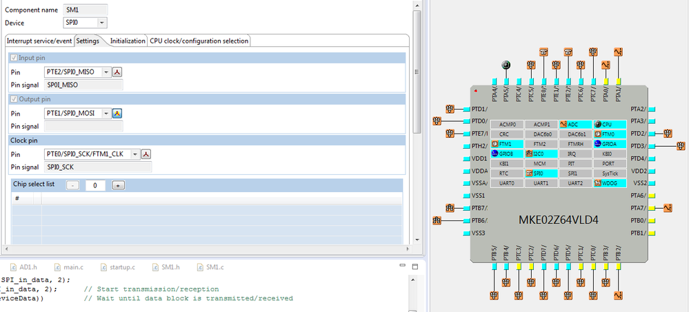

I need to read 2 bytes from one 12-bit ADC using the SPI interface in MKE02Z. I select SPIMaster_LDD from PE and I configure it as shown:
  • No Interrupt service/event
  • Output pin MOSI not used (I only want to read 2 bytes through MISO)
  • No Chip Select is used (I use a GPIO instead)
  • Clock rate: 0.5us
  • Auto initialization: Enabled

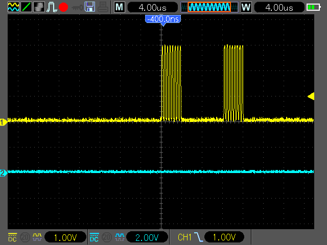

The implementation is very easy but... It does not work as I cannot see the 16 clock on SCLK as expected.

But I don't want to send bytes (OutData) through MOSI (pin39, PTE1). Why I have to use a sending function (SendBlock) in order to receive packets (ReceiveBlock)? I don't understand this method. In my application PTE1 is configured as general purpose digital output. If I use the code above, I see unwanted changes on PTE1 because of the SendBlock() function. I've configured this pin as shown here below but the changes on PTE1 persist.
What can I do to solve this?

How can disable the MOSI pin? I'm not able to uncheck it in the component Settings
One more thing. I've tested 2-bytes reception using ReceiveBlock() and SendBlock() as suggested. It works but there is a big gap (8us) between packets (quite big in my opinion). Is it possible to improve this timing?

The MKE02Z derivative provide allocation of all SPI pins based on SPE bit in the SPI Control Register 1. There is not possible do disable allocation of the MOSI pin on this derivative (see the reference manual).
The delay between bytes can be caused by other interrupts routines or by the SPI interrupt routine itself. What is the bus/core clock frequency of the CPU? You can try to use higher core and bus clock frequency.

I'm afraid I cannot go faster as the bus/core clock is running at 16MHz. Don't worry, so far I can accept the timing between byte packets.
