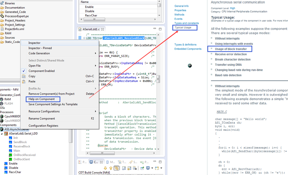

Hello Aaron,
You can use the method of " ASerialLdd1_ReceiveBlock()" to receive more than one char.
There is Typical usage :
Hope it helps
TIC
