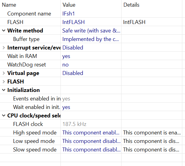

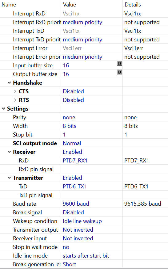

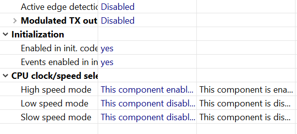

I have a codewarrior 10.7 / processor expert project for the S08mm32.  I am using the processor expert beans for the AsynchroSerial using interrupts (because I need to use the buffer) and the IntFLASH.   If I have interrupts enabled on the asynchronous serial, writing and reading from flash hangs.the processor.  If I don't have interrupts enabled, writing and reading from flash works, but I can't get the asynchronous serial to work (possibly because I can't poll quick enough to service it).  How can I get both to work?
Let me know if there is more information I can offer.
Thanks!

Thanks for pointing me to the other thread.  I feel like I covered the issues described there.  For example, here is how I do my flash writes:
void HandleFlashWrite(){
byte bErr;
if((gbWriteFlash==1)&&(gbNumberOfFlashBytes<37)){
__DI(); // Disable interrupts
bErr = IFsh1_SetBlockFlash(&gbFlashData[0],gwFlashAddress, gbNumberOfFlashBytes);
gbWriteFlash = 0;
__EI(); // Enable interrupts
However, I still end up with my code hung every so often.  Is there more than just disabling interrupts during flash writing that I need to take care of?
  Mike
