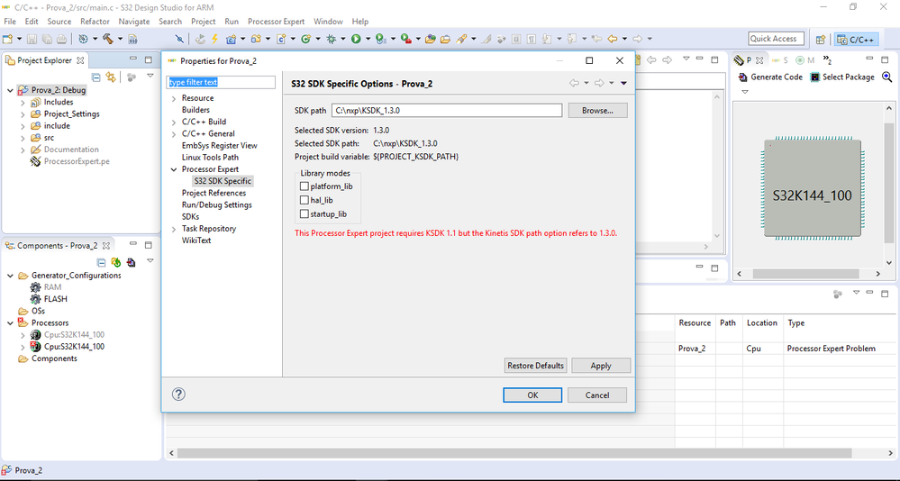

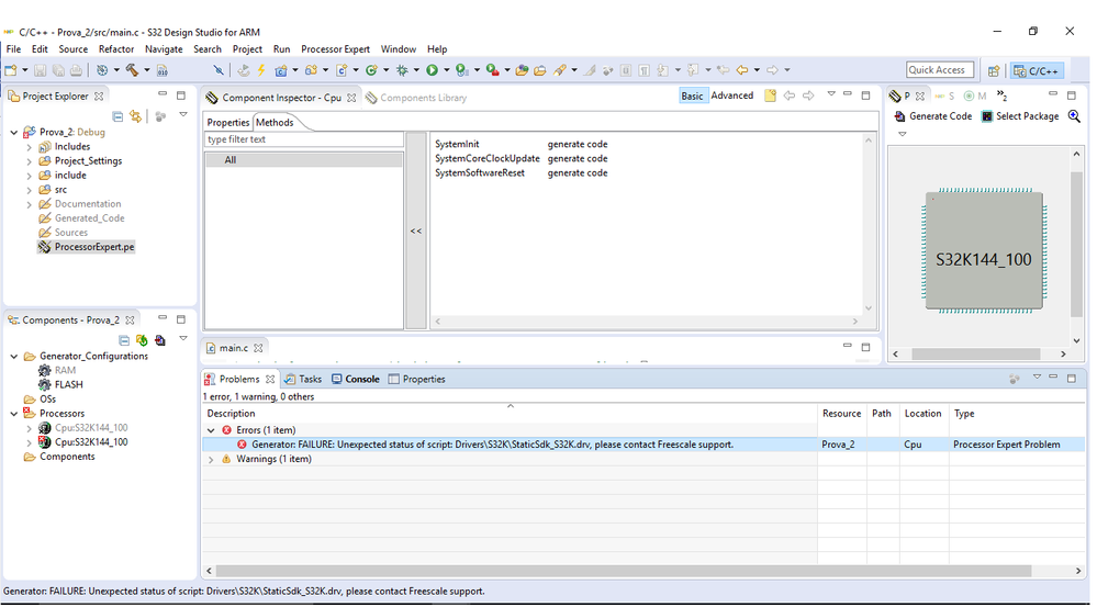

I'm trying to add to my project a Processor Expert file but I have this issue
What is the problem?
Thanks.
1,850 Views
raresvasile
1. Can you provide the steps that you took to add the ProcessorExpert support to the project? We need them in order to reproduce the issue as closely as we can.
2. Please replace C:\NXP\KSDK_1.3.0 in Project Properties->ProcessorExpert->S32 SDK specific with ${ProcessorExpert_loc}/../../S32DS/S32_SDK_EAR_0.8.2. This may resolve the issue as the SDK path should be pointing to a valid S32 SDK location.
Thank you,
Rares
1,850 Views
marek_neuzil
I am not sure what you mean by the " add to my project a Processor Expert file" but the error that is reported mean that the Processor Expert project has been created by using KSDK 1.1 but the selected path refers the KSDK 1.3.0 version. I.e. the version of the KSDK is not the same and conversion of the components (from the version 1.1 to 1.3.0)  may impact settings and functionality of the Processor Expert components (new version of the KSDK drivers).
