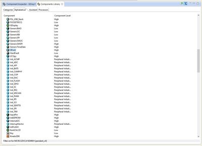

I have a library problem (processor expert). When I run another PC and used to code warrior, LCD library not available. But when I used another PC is work correctly and LCD library available. I tried to many PC about this problem but I didnt take solve. Whats the problem? Could you help me please...

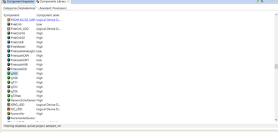

We can see these components (g165,g168,etc..) by disable processor expert filter:
BUT, please note these components are for DSC but not for S12Z products.
Hope this helps,
