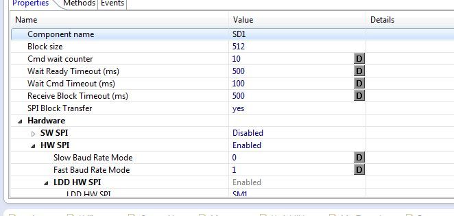

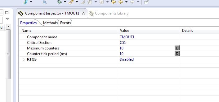

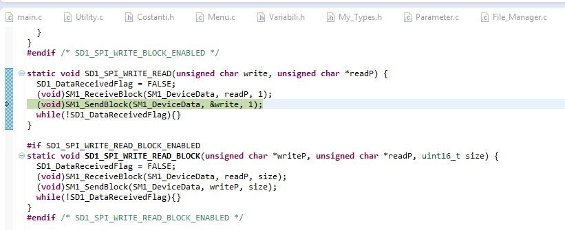

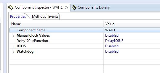

paolocolombo
This is the loop:
The components settiings:

BlackNight
Ok, your settings are reasonable. I think what happens is that the SPI bus transfer gets interrupted, and then the routine waits until the data arrives (which does not happen). So I that waiting loop needs to be changed to an implementation using timeouts.
