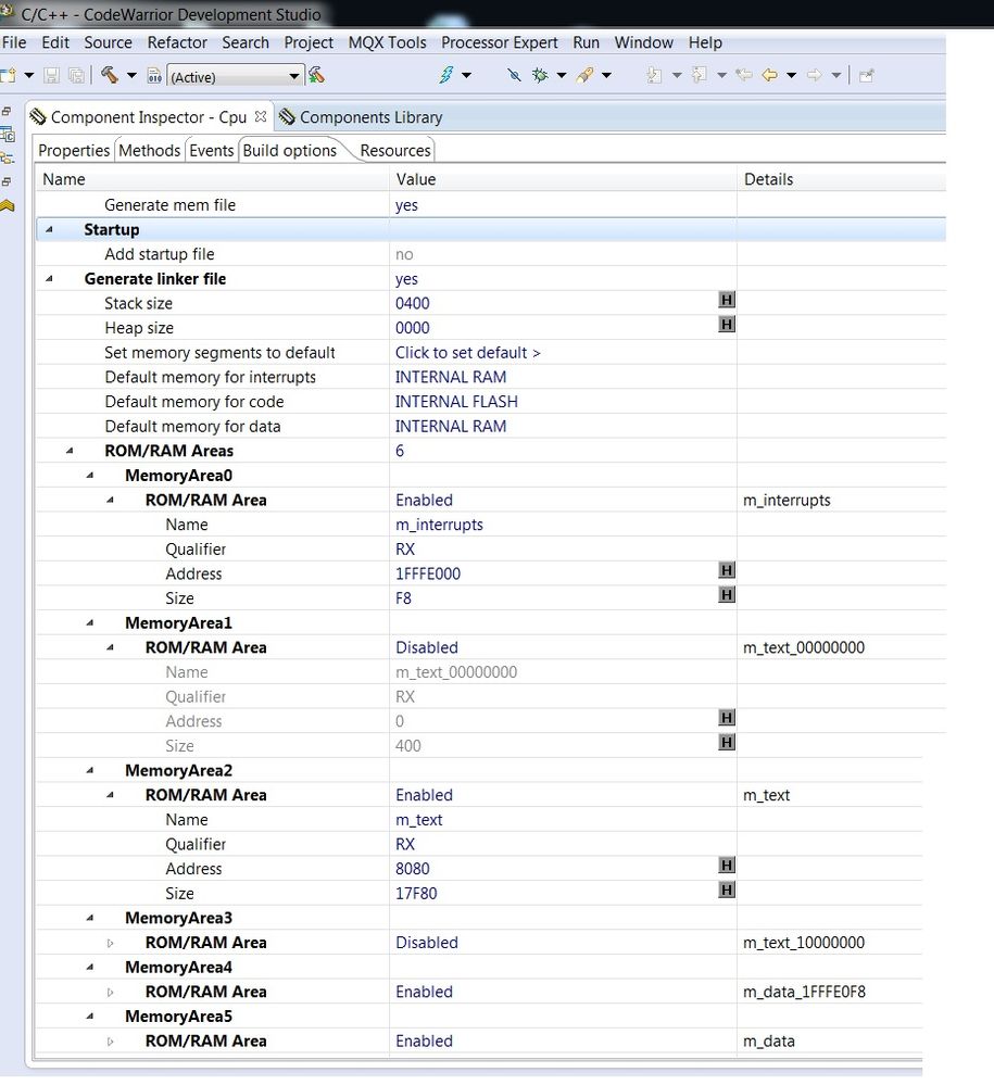

I have set the CPU component as in figure :Hi,
I'm testing the FRDM-K20D50M board (128K flash). I flash it with UTASKER USB Bootloader (uTaskerSerialLoader_FRDM-K20D50M.S19)
I made a little code for blinking a led with Processor Expert
The owner application  reset code must be linked at 0x8080.
Interrupt vectors should be run from RAM or set to a location in the code (not left at 0x00000000)" .
I have set the CPU component as in figure , but it 's wrong.
The Output File Format must be  ".bin" .
It's possible to do it with Processor Expert?
Jerry

You may find useful this post on the MCU on Eclipse blog:
serial-bootloader-for-the-freedom-board-with-processor-expert
Specially in the part Application Memory Map.
There you can also check the S-Record (S19) Application File Generation to know how to create the .bin file.
I hope this information can help you.
