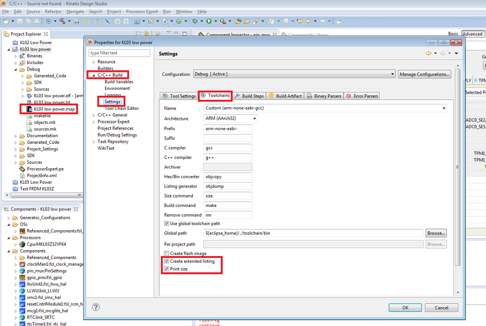

marek_neuzil
Hi Mike,
You can use .map file to check the code size of your application(e.g. Debug\<project name>.map file in your project in Project Explorer window.
But the configuration of the compiler depend on the toolchain you are using. In KDS 2.0.0 (1.1.1) you can use the following  (Print Size option) options to display the code size in the Console window (ARM GCC compiler):

ZhangJennie
hi Mike,
we can check object/code allocation in map file. each module code size can be found in map file too.
the total project code size can be check with referring below document.
Printing Code Size Information in Eclipse | MCU on Eclipse
Zhang Jun
