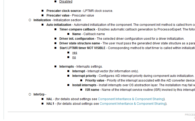

I'm using KDS 2.0.0 and MQX for KSDK 1.1.0 in a Processor Expert (PeX) project using a MK64F12. I've added a low power timer to my project and when I try to generate the code I get the following error message with respect to the LPTMR component:
No inherited component assigned (HAL1)
Looking at the Help on Component for the LPTMR component:
It refers to HAL1 under a properties heading called InhrGrp but the InhrGrp setting does not show up in the Component Inspector for LPTMR, only in the Help.
Can someone help? Thanks.

DavidS
Hi Larry,
I cannot get the error you are.
I have started with a new project for frdm-k64f + KSDK + PE and set the OS to be MQX (not MQXLite).
I then added in fsl_lptmr_hal component.
I did have to enable the clock to LPTMR module and then configure the fsl_lptmr.
My project is attached.
You should be able to unZIP into C:\Freescale\KSDK_1.1.0\.
Then import it.
