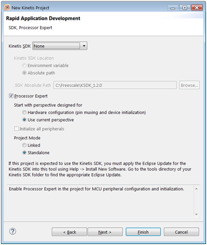

1. Create a new Kinetis project for the same target MCU (navigate to menu File > New > Kinetis Project).
    • Write a new project name (you can write the same name of the original project).
    • Select the same target MCU (or a target board that use the same target MCU).
    • Kinetis SDK – select None
    • Check Processor Expert
    • Select the compiler that is available (installed) in your KDS 3.0.0 installation (GNU C Compiler is available by default).

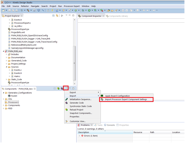

2. Remove all Processor Expert components from the project (delete all CPUs and components if included). All components will be imported from the original project.

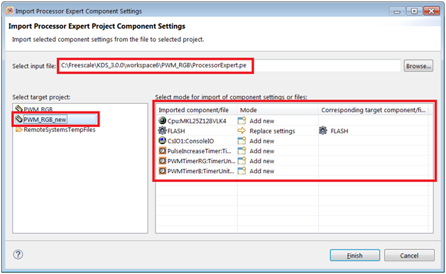

3. In the Components windows, navigate to the View Menu > Import > Import Processor Expert Component Settings
4. In the Import Processor Expert Component Settings windows, click on Browse button
5. In the dialog, select *.pe file extension and select the ProcessorExpert.pe from the original CodeWarrior Processor Expert project. Click on the Open button.
6. In the Import Processor Expert Component Settings windows select the target project (the new project).
7. The window contain list of all components that can be imported (added). You can select components that can be omitted (all will be imported by default).
8. Click on the Finish button. All selected components are imported and no warnings and errors should be reported.

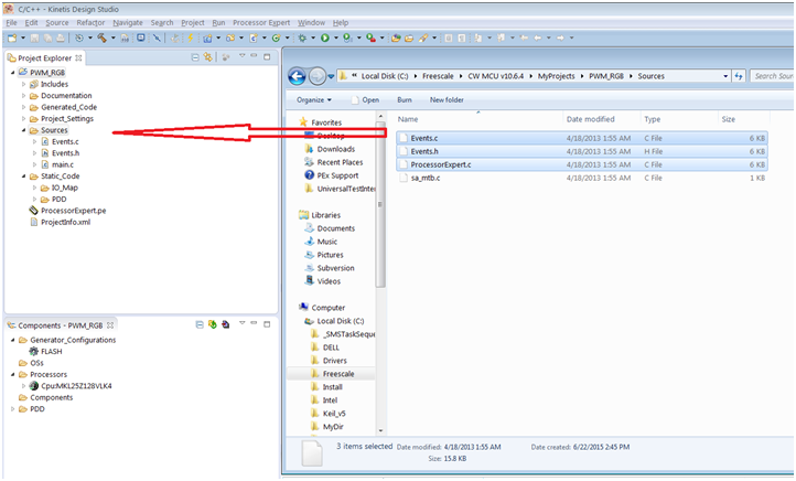

9. Open the folder with the original CodeWarrior project and drag-and-drop source code files (copy files) from the  CodeWarrior project into the new project created in KDS (select Copy files).
  Please note, that CodeWarrior projects have the main() function in the ProcessorExpert.c file but the Kinetis Project uses the main.c (copy the content or you can rename the copied ProcessorExpert.c file)
