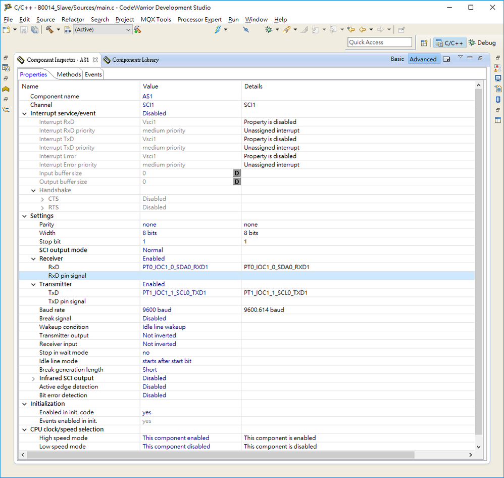

We are using S12ZVCA & CodeWarrier 11.0.1
How to set pull-high/low for SCI?
PERT=0x03;       // SCI1(PT0, PT1) Enable Pull Resistor
PPST=0;             // SCI1(PT0, PT1) Pull High

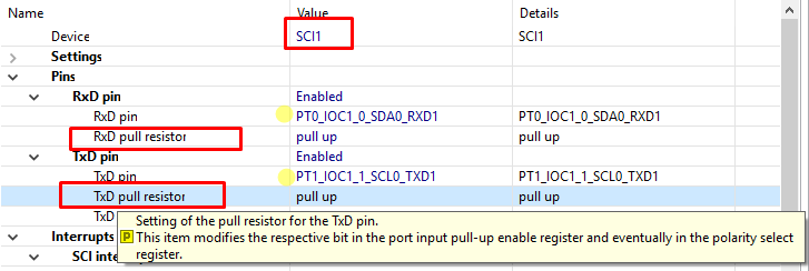

Hi Aaron,
Yes, that is what I mean (add that code by yourself).
The setting from my screenshot is available only in the init_SCI component.
Diana

Hi Aaron,
Could you try to use settings below?
I hope it helps.
Diana

Hi Diana,
What version is your CodeWarrier?
Aaron

Hello Aaron,
I would like to apologize for the delay.
I have used the same version of CW, but a different component.
However, if the SCI transmitter feature is enabled the effect on enabled pull device is forced off.
Only the SCI receiver can be controlled by PER/PPS.
But the pull-up functionality is not available in the AS1 component. So, you can set it in the user code section.
Diana

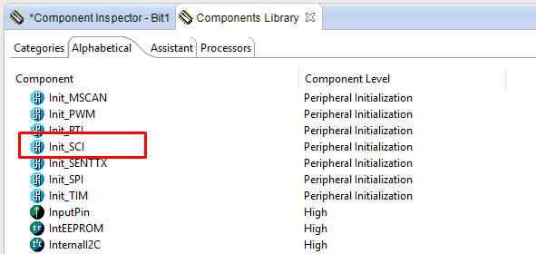

aaronlee
Contributor V
Hi Diana,
Thanks for your reply.
Do you mean I need to add the following code by myself?
main(){
   PERT=0x03;
   PPST=0;
I have been try to install CodeWarrior v11.1, but the result same as v11.0.
Then, I try to use AsynchroMaster and AsynchroSlave, the result same as AsynchroSerial.
I could not find PULL RESISTOR as your screenshot.
Aaron

dianabatrlova
Hi Aaron,
Diana
