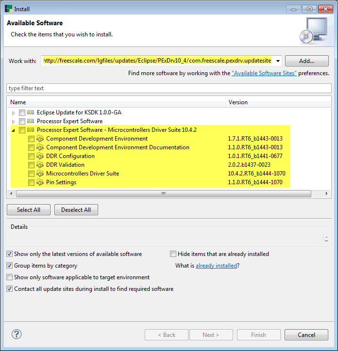

The Processor Expert Driver Suite 10.4 Update 2 is available on the Freescale web and as Eclipse update.
This update applies to the Driver Suite 10.4, or 3rd party IDE's with Processor Expert as Atollic TrueSTUDIO or Emprog Thunderbench.
It is NOT applicable to CodeWarrior or Kinetis Design Studio: the upcoming KDS V2.0.0 release will include that update.
This update features an improved new project wizard with device filtering support, alignment with the Kinetis SDK v1.0.0 and the upcoming SDK v1.1,
and includes bug fixes (see release notes for details). The update is cummulative, so you can apply it to Driver Suite 10.4 with or without the Update 10.4.1.

Download from the web:
http://www.freescale.com/webapp/sps/site/overview.jsp?code=PEXDRV_UPDATES_10_4
Then update Eclipse with Window > Install new softeare and use the downloaded archive.
Eclipse Updater:
Use the following update URL to download the update 10.4.2 (menu Help > Install New Software):
http://freescale.com/lgfiles/updates/Eclipse/PExDrv10_4/com.freescale.pexdrv.updatesite
