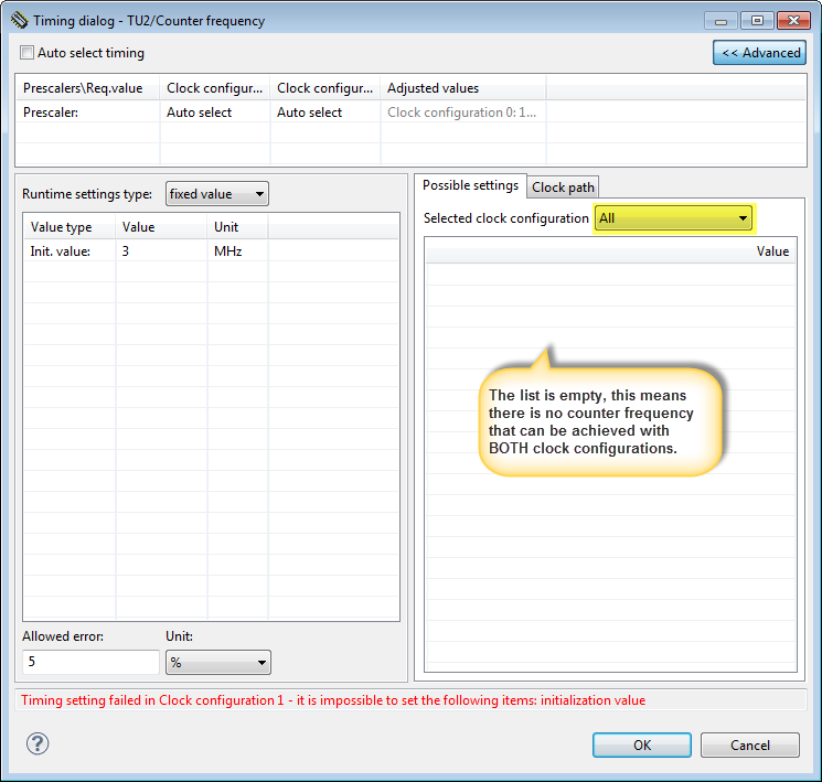

and if i am using some other timer TPM0 and in setting i enabled config 0 and 1 for TPM0.
I m not able to set the counter frequency and the overrun period as shown in the attachment.
2) How can i use other timer in VLPR mode?

2) Now, if instead of LPTMR, you decide to use TPM, the problem you showed with your picture is because the TPM Counter Frequency property (in this case 3 MHz) cannot be achieved with both Clock configurations (0 and 1). If you click in the button (...), it will open the Timing Dialog Box. At the right side you will see the possible clock frequency options. If the list is empty, this means that there is not a common frequency you can select. To solve this you need to play with the clock configurations in the CPU component. Here are some pictures I took from your project to show you my point:
Hope this helps. Let us know if you need more details.
