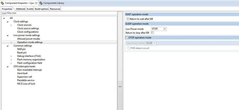

In a future version of Processor Expert for the MK22FN512, would it be possible to add an option to enter the VLP STOP mode from run (in Operation Mode Settings - SLEEP Options)?
Right now the only three options for SLEEP are: STOP, PSTOP1 and PSTOP2.
It is always possible to modify the CPU_Init.c file directly of course, or to use a custom function to replace it. But adding the options in the Processor Expert GUI would be nicer!

brunopaillard
Hi Jorge
Either I do not understand the text in the document that you sent, or there is an option missing (exactly the option that I am suggesting I think).
Regarding sleep modes (not run modes), in the last part, Petr's document indicates:
"For example the DOM_SLEEP can be mapped to normal stop mode, very low power stop, partial stop 1 or partial stop 2 of Kinetis L"
But the image below it only shows 3 options: Normal STOP, PSTOP1 and PSTOP2. Allowing the VLP mode checkmark above has no impact on the code (I checked).
What I am suggesting is to add a VLP STOP mode menu option, which is exactly what Petr seems to say already exists...

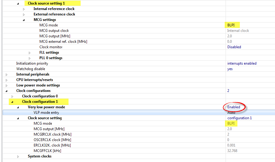

adriancano
Prior to enter VLPS mode you need to enter a VLPR mode, this is what is indicated in the mentioned document. To accomplish this you need to set a Clock Configuration for BLPE or BLPI mode checking the Very low power mode as enabled, here an example:
You enter the Clock configuration calling the methods Cpu_SetClockConfiguration(); and Cpu_GetClockConfiguration();. After ensuring you are running the BLPI or BLPE configuration you call the Cpu_SetOperationMode(DOM_SLEEP, NULL, NULL) to enter VLPS mode. This is the normal behavior of the MCU you can check more information in the AN4503 document. Referring to it:
"STOP mode entry routine:
if in Run mode puts the processor into normal stop mode.
If in VLPR mode puts the processor into VLPS mode.
In this mode core, bus and peripheral clocks are disabled."
As you mentioned before it is possible to enter VLPS mode from Normal RUN mode but this is not implemented in Processor Expert.
Hope this information can help you
