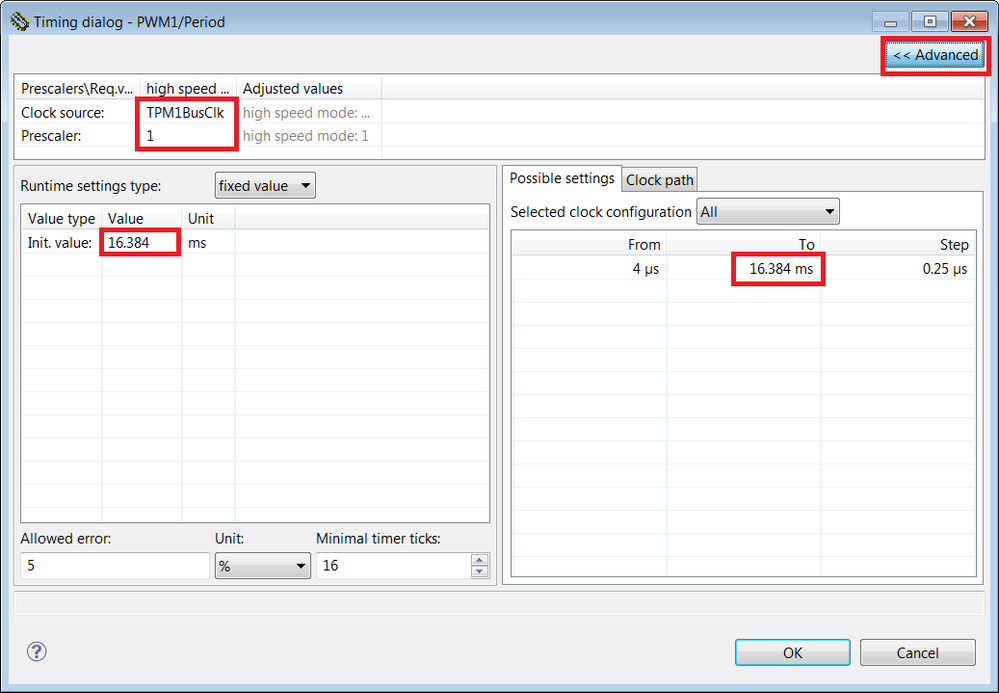

The SetRatio16 method (of PWM component) sets a new duty-cycle ratio. Ratio is expressed as a 16-bit unsigned integer number. 0 - FFFF value is proportional to ratio 0 - 100%.
If you want to use the maximal precision of the TPM device you must use maximal value of the timer counter module value (0xFFFF), i.e. when the TPM timer count from 0 to 0xFFFF the SetRatio16 method writes the 16bits value directly to the compare register of the used channel. for example, if the timer counter module register is initialized to 0xFF the maximal value of the compare register is also 0xFF. See the following example for the default QD4 project in CW MCU 10.6:
Add the PWM component in the project and open the timing dialog of the Period property, select the clock source and prescaler and select the maximal value of the Init. Value:
The PWM_Init contains following initialization value of timer counter modulo register value:

alexit
Marek,
I think I am running into a clock limit of the QD4 device. I have TPMBusClk and Prescale 1 like you have shown. I would like the PWM set with a 64us period and the ratio at 16-bit (TPMMOD 65536 or 0xFFFFU). When I try adjusting the minimal timer ticks to 65536 I get an error message that timing value cannot be set, actually with the 64us period I see the TPMMOD value is set 256 0xFFU), any minimal timer ticks above 256 displays the same error message. The only way to increase TPMMOD is to decrease the period (which I cannot do.)  I found in the CPU portion the Bus Freq Divider was set to 2, changing this to 1 has doubled the TPMMOD value to 512. I am testing with this value now.
