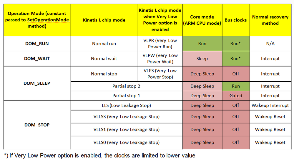

The following table shows an example of the operation modes mapping for Kinetis L that shows the state of the core, bus and recovery method for each mode:

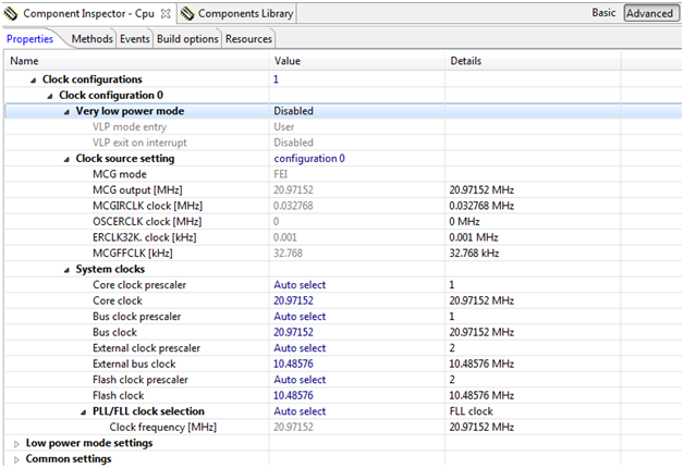

The Very low power mode option is available in Clock configurations of CPU properties (see below), i.e. the selection of the power mode is done by combination of the SetOperationMode and SetClockConfiguration methods.

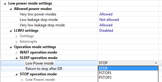

The exact mapping of the DOM_xxx options can be configured in the CPU component inspector (the Advenced view has be enabled). For example the DOM_SLEEP can be mapped to normal stop mode, very low power stop, partial stop 1 or partial stop 2 of Kinetis L.
