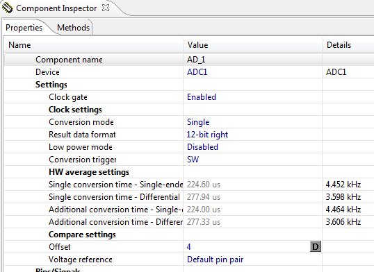

When I use the MK60DN512VMD10 cpu and configure an Init_ADC component type I am able to specify the Offset value, which when code generation is done produces the appropriate register setting:
Offset is present (and set to 4)Offset is present (and set to 4)
Generated code:
// from the comment block at the start of the file:
**              Compare function                           : Result < CV1
**            Offset                                       : 4
**            Voltage reference                            : Default pin pair
// then later in the Init function
  /* ADC1_OFS: ??=0,??=0,??=0,??=0,??=0,??=0,??=0,??=0,??=0,??=0,??=0,??=0,??=0,??=0,??=0,??=0,OFS=4 */
  ADC1_OFS = (uint32_t)0x04UL;

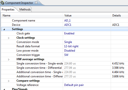

However, when I switch to the MK60DN512ZVMD10 cpu the offset value is missing from the "Settings group":
'Z' cpu missing Offset'Z' cpu missing Offset
Unsurprisingly the generated code is then also missing the corresponding line from the comment block, and the actual write to the registers.

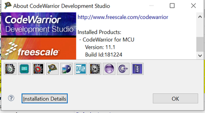

HI PhilV
I tested this with CW11.1, I couldn't reproduce it on MK60DN512ZVMD10. See below screenshot
Where is missing?
Jun Zhang

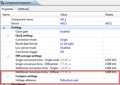

PhilV
@ZhangJennie - thanks for that, looks like I might need a CodeWarrior update, I am running CW10.2 and the Z device doesn't show it:
I had assumed (apparently incorrectly!) that being an older device the support would be the same. I'll try updating and see if it 'appears'.
