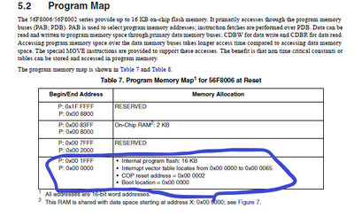

From the following screenshot, you can see that the MC56F8006 has only 16KB flash, 2KB RAM, so you have to care about the RAM utilization.
Because you do not write data in application code, so you do not need allocate space for the PRAM.
Because you do not use malloc() to dynamically allocate memory, you can set the heap size to zero. The stack is required.
