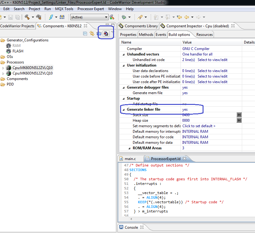

TICS_Fiona
1) Please enable the 'Generate linker file' under 'Build Options' in CPU Componnet Inspector.
2) Click on 'Generate Processor Expert code' button to re-generate code
The generated link file will be placed under <\Project_Settings\Linker_Files\> subfolder with the name *.lcf, or *.ld, or *.cmd.
If this does not help, would you please attach the project? Thanks!

om
Hi Fiona
Sorry for the late respond
I was not near a computer.
Attached the PE project.
RAM config linker file isn't created.
FLASH, yes.
OM
