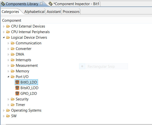

The release notes say that GPIO Driver is obsolete and that I should use LWGPIO driver instead. And if fact in the example program I'm looking at (gpio) it does indeed use the LWGPIO driver.
But in my installation, PE does not seem to know that there is such a thing. Only GPIO is listed in the component library. So if I want to add a GPIO point, I don't see how I can make it LWGPIO.

could you please be more specific what do you need to do? However I think you mix two things together, MQX has own drivers and PEx too.
MQX for GPIO supports GPIO and LWGPIO. PEx encapsulates GPIO device by GPIO_LDD component.
For details please see corresponding documentation.

I've created a new MQX_Lite project. I'd like to add some simple bit input and output using lwgpio. But here's what my Component Library looks like:
No lwgpio shown.

please note that lwgpio is an MQX driver. Processor Expert does not support MQX drivers, it provides its own components (that generate drivers) called BitIO_LDD, BitsIO_LDD, GPIO_LDD. Use these component to access GPIO in MQX lite project.
Please note that there are generally two flavours of MQX:
- MQX which containts it's own drivers and hw support using BSP and PSP pacakges. BSPs can be compiled with using PEx drivers.
- MQX lite - it's basically only the core without drivers. MQX lite is delivered as PEx component and is to be used in PEx project with PEx component drivers.
