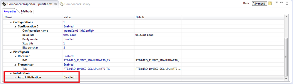

Hi Roland,
I suppose you are using fsl_lpuart component from SDK. There is known issue - the LPUART device clock source  selection in SIM device is not done by the fsl_lpuart component (the default value is "clock source disabled"; see the after reset value of LPUART0SRC bits in SIM_SOPT2 register). This defect has been fixed in the upcoming SDK 1.1 release (it will be publushed soon).
You can use the following workaround:
Disable autoinitialization in the Component Inspector of the fsl_uart component in the project:
And use the following initialization code of the fsl_lpuart component in your application (it must be used after PE_low_level_init() call in the main() function). See example below:

The clock source is selected in the SIM device (LPUART0SRC bits in the SIM_SOPT2 register) and the baudrate is correctly initialized by the LPUART_DRV_Init() method.
