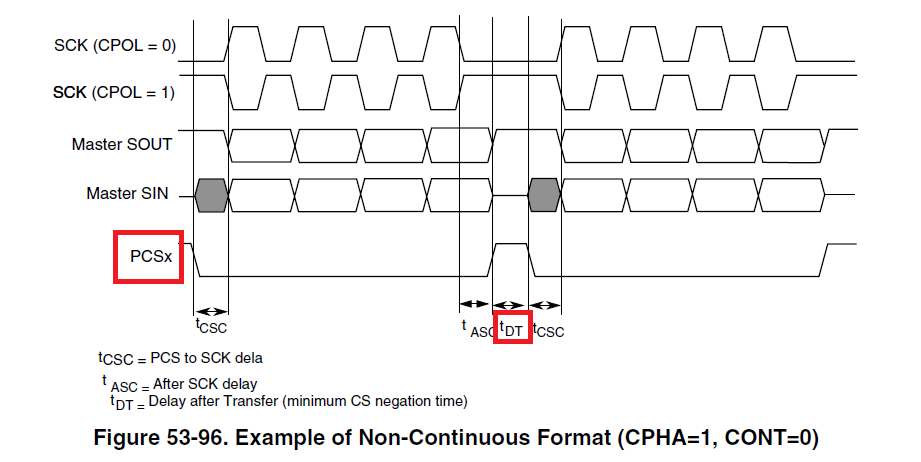

When config the SPI component on CW-PE,  there is a choice "Chip select toggling" . what's the meaning ?
And on matter  i choose yes or no , the register "SPIx_PUSHR->CONT" is "0" .
And if I want the PCS signal (SPI_MASTER) is all ways  low , where and how should I config ?

Hi Linda,
The Chip select toggling property is used for enabling/disabling of continuous selection format (CONT bit in the SPIx_PUSHR register).
When the CONT bit = 0 (Chip select toggling property is set to yes), the DSPI drives the asserted Chip Select signals to their idle states in between frames. The idle states of the Chip Select signals are selected by the PCSISn bits in the MCR. The following timing diagram is for two four-bit transfers with CPHA = 1 and CONT = 0.
See the reference manual of the derivative, chapter SPI (DSPI) for more details, e.g. K60P144M150SF3RM.
In your case (SPIx_PUSHR registrer, CONT = 0) the PCSx signal should be toggled. Please, check the setting of the PCSx pin, iddle state and the delay between transwers (Delay between chars property) of SPIMaster_LDD component in your project.
You can also see that the CONT bit settings is initialized in the Init method of the SPIMaster_LDD component, the corresponfing bit (bit number 31) of the DeviceDataPrv->TxCommand:

This  value of TxCommand is used in the itnerrupt routine when the value of the PUSHR is written, see the source code below:

Please note that this code depends on the settings of the SPIMaster_LDD component (I have used the default settings with interrupts service enabled).
