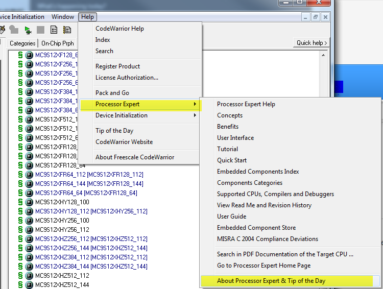

rayhall
Contributor V
Hello Jennie,
I have "Processor Expert 3.05 for HCS12(X)". See screen shot of the about screen.
Even if I have a old version of CodeWarrior, I should have support for these BEANS as I have the Standard Perpetual, and this supports the BEANS according to what it said on the website when I bought it.
Ray.
2,590 Views
ZhangJennie
Under beans package install, there is !README.txt.
It mentions these components are for pe3.01
Other pe versions other than 3.01 are not guaranteed to function normal. Thus I suggest you use the recommended system.
Besides, The components in this archive are available for free and without any warranty
to the users of Standard or Professional CodeWarrior suite.
Please note that these components cannot be used with Special or Basic suite.
