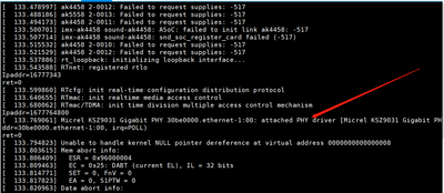

       I'm having trouble trying IMX8mm. linux-imx 5.7.40.2.3.3 from NXP github.and I patch to linux-imx 5.7.40.2.3.3 with  xenomai3.1  I use IMX8mmEVM board.Port rt_fec driver. when  I run rtnet,I'm having the following problem。

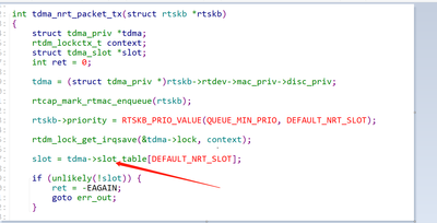

and  I objdupm  identified some problems。
I use the resources you posted and run into the same problems. I put in the drivers and patches you released, and I had the same problem。Expect to hear from you。

Hi Roby,
   i.MX8MM EVK board use AR8031 as Ethernet PHY, but I see it's KSZ9031 in your log. So you don't use iMX official EVK board, right? if yes, you need to check your device tree. In addition, you need to check enable-Xenomai-driver.config in release package of xenomai-arm64, if you apply the config for you kernel config.

Hi,xiaodong
     yes,I use chunaglong(创龙) IAMX8mm EVM, PHY is KSZ9031,but,PHY   is  attached ,I'll check the configuration again,Thank you。
