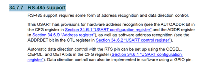

xiangjun_rong
As the following section in UM11026.pdf, you can connect the RTS signal to the the direction pin of RS-485 IC, which can control the direction automatically when you send character.
Maybe there is problem if you use GPIO pin to control the direction, because there is only TXEMPTY bit in FIFO status register, which means that the FIFO is empty, the data has been copied to the shift register, but it does not reflect that the sift register has completed the data shifting.
Hope it can help you
XiangJun Rong

xiangjun_rong
I am sorry, I mean the UM11126.pdf rather than UM11026.pdf, the UM11126.pdf can be downloaded from the link:
https://www.nxp.com/products/processors-and-microcontrollers/arm-microcontrollers/general-purpose-mc...
You can refer to the section 34.7.7 RS-485 support in UM11126.pdf
Regarding your question to use GPIO to control the direction of RS485 chip, it seems okay that you disable Transmitter FIFO, check both the FIFOSTAT[TXEMPTY] and the STAT[TXIDLE] before you set the GPIO to enable transmitting and write the transmitter data.
Hope it is helpful
XiangJun Rong
