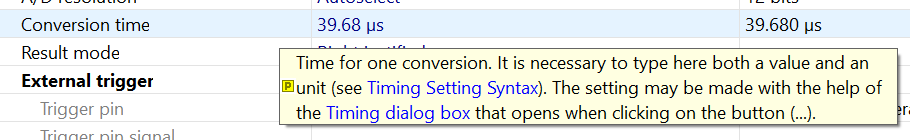

We are trying to measure current in S12ZVCA project. The current range is -500A ~ +500A. We will use current shunt and OPAmp to convert current to voltage.
Does the S12ZVCA support -2.5V ~ +2.5V ADC reading? Do We need 2 ADC channels  for positive and negative voltage reading?
We need to calculate capacity of power. pastedImage_2.png We are setting the 64MHz clock(Bus clock=32MHz).
What is the relation of Number of conversion and Conversion time ?
Do you have any recommend?

Hello Aaron,
- "Conversion time ": The time for one conversion。
-“ Number of conversion ” :To be more precise , we can use average ADC data, so the Number of conversions
is the numbers of one measurement.
 -“Does the S12ZVCA support -2.5V ~ +2.5V ADC reading? ”
  I think the S12ZVC ADC only can read positive data ,so you need convert the negative to positive .
 While do you mind create a new case about this question to S12Z hardware thread to make sure :
