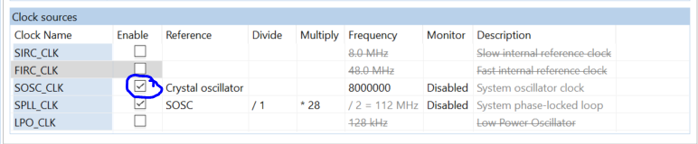

I am new on the processor expert and NXP 32bit MCUs. I want to select only the external oscillator in the clock setting.
  • How can I configure the external oscillator and then PLL
  • system clock should also be based on SOSC
  • Bus clock is also drive from SOSC
How can I verify#@ whether I select correct clock or not?

To enable/disable the clocks there's a little checkbox in the Clock Sources table:

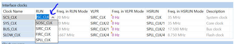

In the Interface Clocks table you can select the clock source if you click in the SCS_CLK option:
If you change the SCS_CLK the BUS_CLK will have the same clock source.

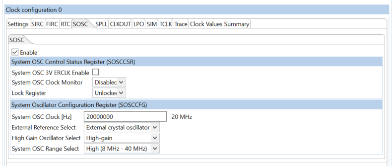

Also in the Clock configuration table, if you click in the tab, more configuration options will be displayed:
Let me know if this helps you.
