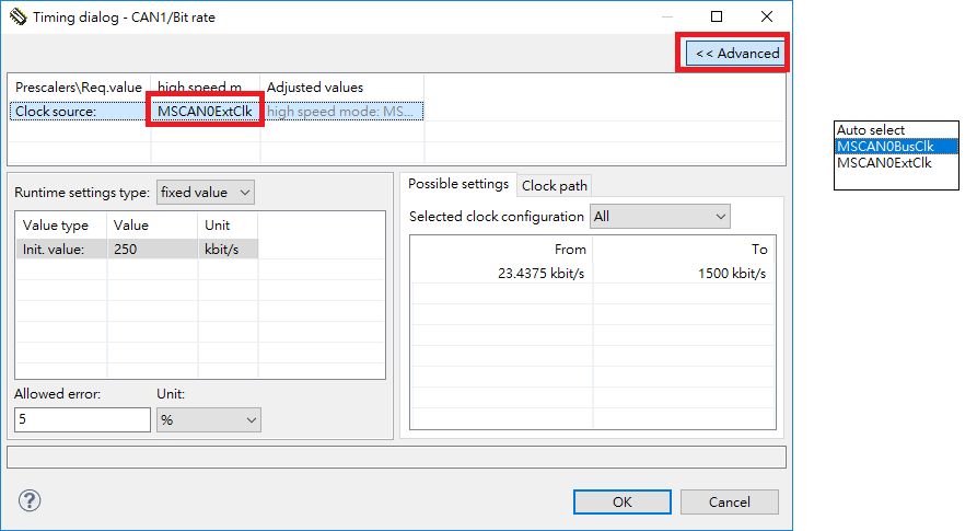

We use S12ZVCA in my project.
How to select CLKSRC of CANCTL1 in Processor Expert.
0 MSCAN clock source is the oscillator clock
1 MSCAN clock source is the bus clock

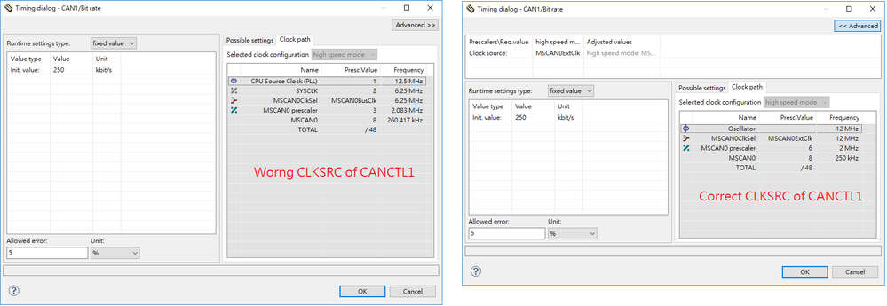

I found it.
Aaron
