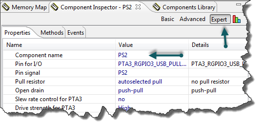

If I create a UART embedded component, it will assign a name: AS1:Serial_LDD.
How can I change the name for me easy to remember, for example change it  to: Command_Uart:Serial_LDD ?

BlackNight
Hope this helps,
Erich
