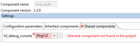

I'm currently using a MK22FN128VLL10 and don't need fsl_debug_console.  If I remove the component, then I get an error in the OSA component:
What do I need to do to remove it?

hi dave,
yes, you can enable/disable printf definition in code, but processor expert still requires enable DbgCs1(there is no pe interface to have it disabled.)
you would summit a case to nxp support team for feature request.

Hello dave,
Does you use the "MQX Lite "  OS ? If yes,  fsl_debug_console is the essential part ,
so i think it can not delete .
And if you use the MQX Standard , you can delete the component , then only configure one UART to print.

Hi Alice, yes, I'm using MQX Lite.  Couldn't FSL (NXP) change the KSDK so that fsl_debug_console isn't required?  What *must* be printed?  I would think that a preprocessor definition would be useful for this, in addition to removing the requirement from the PEx component inspector.

Hi dave,
this is because MQX lite uses debug_console generated functions.
for example, when we use printf, it acctually called debug_printf which is defined in debug_console component.
can this help you?

Hi Jennie, I just went back to my project to do some other testing, and found that adding "BSPCFG_ENABLE_IO_SUBSYSTEM=1" to the C precompiler settings didn't help.  Processor Expert still requires that DbgCs1 be enabled, so it looks like I cannot get around this.  I think my only option is to still include the minimum necessary C files from the KSDK to allow compilation to continue.
