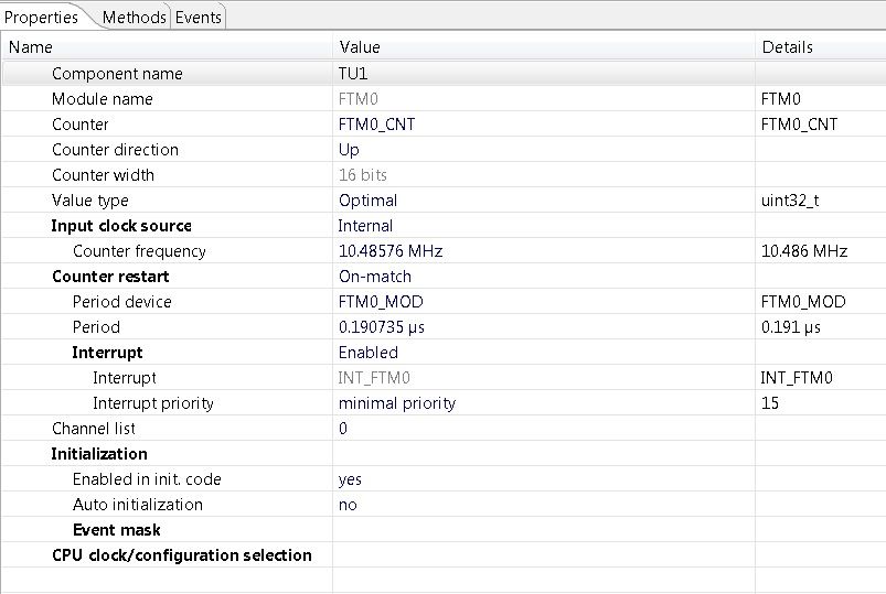

I'm using Prosessor Expert for the programmation of the K60D100M tower.
I've added a Timer Unit, and i want to use the GetPeriodTicks function but at the end of that function, after the return,
the programm stuck in the hard fault.
I had a look to the HSFR Register but the of VECTTBL and FORCED bit have value 0
The timers works well, and i can even chanche the frequency by using the SetPeriodTicks function, but when i try to get the
value of tick per period i get stuck in the PE_ISR(Cpu_ivINT_Hard_Fault).
Any advice?

vfilip
could you please post here some simple project in order to reproduce it on our side? generally such behavior should not occur in case of using LDD components.

zenomaspoli
Here's a piece of program that is already enough for get the hadr fault, this program will never reach
the "fcounter=1/TU1_GetInputFrequency(TimerData)*(uint32_t)Period;" command

zenomaspoli
Founded out !
doing like that the pointer 'Period' wasent inizialised,
I've added an ' TU1_TValueType  Period ' and chanched the old in ' TU1_TValueType*  Periodptr ',
and than just: Periodptr=&Period;
I dont know if its the best way, but it works.
