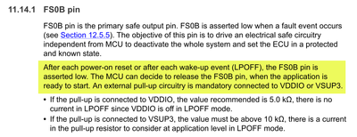

Fault led is on when my power supply is connected. I am not using the powersupply came with the Evaluation Board as it is not suitable for UK. I need a converter for it. Do you think it is the power supply that is causing the problem as LED is not blinking when example project is downloaded.
1,681 Views
lukaszadrapa
Hi Krishna,
that's no problem. It's expected behavior. Here is the explanation from documentation of system basis chip FS65xx:
Lukas
