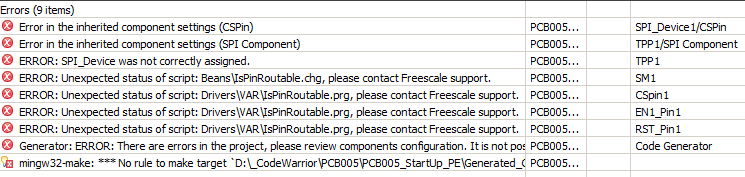

I have an MC33937 connected to a MagniV (S12ZVML) controller and wanted to use the TPP_MC33937 SW from the TPMC-PEXPERT-SW package. After adding the TPP_MC33937 to my project in codewarrior 11 and setting the parameters, the code does not compile and give the error mesage "erro in the inherent component seetings" for the BitIO_LDD module, and that I should, well, contact Freescale support. I have no idea where to start with this.
Any help is much appreciated!

I set this up using the instruction in KTTPMCPEXPERTUG.pdf. So with a bareboeard project I added the TPP_MC33937 to the project. First I added the settings for TPP1: TPP_MC33937 - here I set the EN1 pin and the RST pin, The INT pin is disabled since it is not connected on this board.
Then I went to the parameters for SM1:SPIMaster_LDD and set the pins for MOSI, MISO and SCLK and the clockrate
(which btw came in time and not in MHz like in the example in KTTPMCPEXPERTUG.pdf. Can this be changed?)

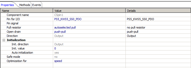

Then came CSPin1:BitIO_LDD where I set the pin for CS
Save and compile gives these errors:
and this shows up under properties for SPI_Device1:SPI_Device
